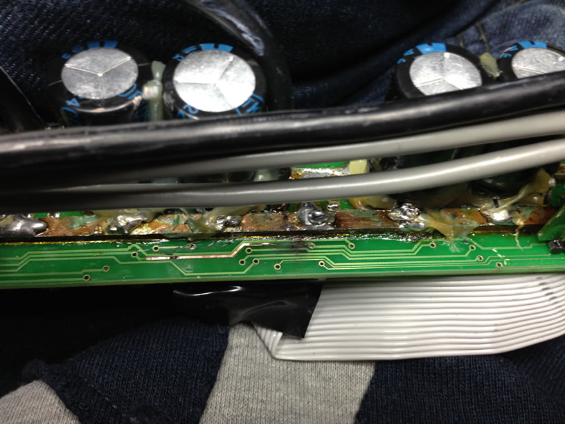

Max E Controller trace melted when charging
Автор crea2k3, 24 Дек. 2014 в 17:25
crea2k3

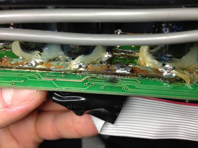

So today I was charging my bike, as normal like I usually do and have done many time. The bike is nearly fully charged and I see a big flash from the battery box. I thought at first one of the lipo packs had exploded, so I opened the box up after turning off the power, checked all the cells and they are all fine. I checked the display and it is turning off and on in a loop. I tried flashing the controller and this works fine. After flashing the controller I restart and the display turns on and off again in a loop. I have opened up the display and controller, inside the display looks fine, inside the controller one of the traces from one of the fet power boards has totally smoked itself !. Iv used the controller for 900 miles now, and although I had some problems to begin with, the last 850 miles have been totally fine. I was charging using the charging coil and my HP ESP120 charger as usual, nothing had changed from normal.
https://www.youtube.com/edit?video_id=khiCp4dlCvs&video_referrer=watch
Im going to re epoxy the trace this afternoon and try re soldering it, quite why it has exploded I dont know, but something was putting too much current through it that's for sure !.

проверь датчик температуры под радиатором, у меня точно так же выгорела дорожка и датчик температуры.
