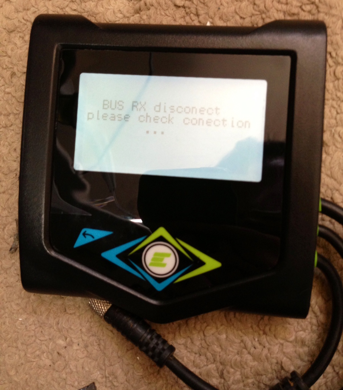

Has anyone seen this error on the Adaptto Max-e controller before ?. I sent it away to be fixed after it got water damaged, they fixed it, I paid the bill, it arrived back and has just been sat in the box since June as I have waiting on Hobbyking to get in my Multistar batteries.
I get my battery delivery and plug in the controller before I go to fit it on the bike and I get the error "BUS RX disconnect please check connection" , I have checked each wire with a multimeter from the display board all the way back to the brain board on the controller and each is fine, so they not check these things before sending them back ?!,
This is the first time its been connected since its been back.

[user]crea2k3[/user], please check that display connected with proper wire. Display connector is blue.
crea2k3
Hi, yes it connected to the blue wire, when it didnt work I also tried the red wire, just in case they mixed it up when repairing it, but it wont work with either, and displays the same message.
andreym
This message mean that the power wires in the display 4-wire connector are ok, but one or two signal wires are broken or misplaced.
I`d try to switch them. The there are black, red, brown and orange. iirc, data wires are brown and orange.
But it also could be a problem with a controller\display connector (some wire unsoldered or broke)
have you sent the display with controller for repair or just the controller box itself?

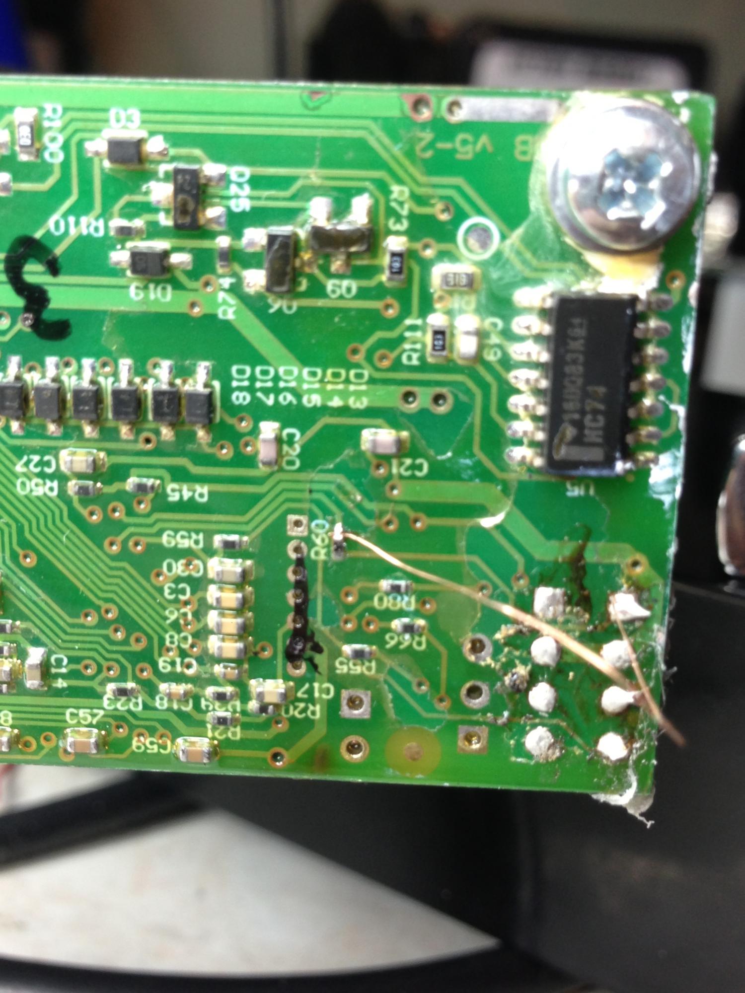

I have now diagnosed the problem, and the controller is alive again !.
I tested resistor fuse R60 for the RX line with a multimeter and it showed as 'OL' which usually means its bad. So I soldered in a jumper from RX input to the other side of R60 and the controller now works. I just need to know the value of R60 now so that I can replace it with my hot air rework station (I own mobile phone repair business).
When I sent off the controller and display to be repaired they put a new plastic housing on the display, so it looks like they didn't disconnect the display from the controller when they did this and shorted out the RX line when soldering.

Подобная проблема возникает крайне редко.
Причин может быть несколько:
1) Как в данном случае - неисправный R60 - замена решила проблему
2) Залив дисплея (наиболее популярный случай)
3) Разрывы контактов

Вот и у меня та же проблема. Как получил: приехал нормально. Поставил байк к дереву. Привязал. Отошёл на 10 минут. Прихожу. Отвязываю. Собираюсь ехать - все работает как обычно, однако на дисплее такое же сообщение! Все в принципе работает, но вместо спидометра и всех остальных данных это сообщение. Дождя не было. Как? Чего? Откуда? Непонятно. Провода вроде все на месте, хотя может и разрыв где-то. Как он мог случиться тоже неясно. Буду ездить так. Все равно никак не починить.
// Разобрал дисплей. Проводок коричневого цвета отпаялся. Помечен как RX как раз. Однако при присоединении его на место, откуда он оторван, ничего не меняется. Похоже вместе с обрывом произошло что-то ещё. Видимо ремонту не подлежит.

Хха!! Контроллер ожил! Даже своими лисьими лапками смог починить.
