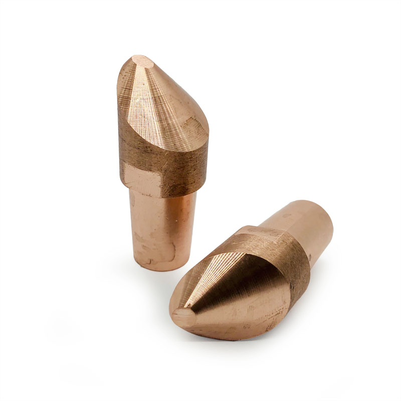

ELECTRODE TIP SHAPES AND POSITIONING
Electrode tip shape can play an important role in achieving desired weld characteristics. Several different sizes and shapes can be used to manipulate weld results in your favor. Experimentation with size, orientation, and geometry can often lead to increased weld strength and longer times between necessary electrode cleaning. Below are some electrode tip shape examples:
1. The stepped down eccentric tip is often used for battery pack tabs and other series welding applications that require the electrode tips to be close together.
2. Tapered tips can be used if the distance between tips isn't as critical. As the tip diameter is made smaller in relation to the shank diameter, the weld energy will become more focused and penetrate more fully, but the weld spot diameters will be smaller.
3. As the tip diameter is made larger, sticking is less likely at higher energies and the weld nugget will be larger in diameter, but more weld energy will be required to achieve strong welds.
4. At higher energies and for difficult geometries, it can sometimes be helpful to have a nontapered tip (the tip is the same as the shank).
5. A hemispherical (rounded) tip may help reduce weld splash and create a smoother weld spot, but flat tips are easier to maintain/create and will suffice in most situations.
6. Wedge shaped tips can be used for welding wires and tubes when access to the bottom surface is limited or isolated. The long narrow surface of the wedge tips helps ensure that contact will be made with the wire and makes it easier to position for welding.
7. A notch can be cut into the wedge tips to help alleviate the necking that can occur when welding solid wires. The notch also helps gather all the strands when welding stranded wires.
ELECTRODE MATERIAL CHOICE
Spot welding electrodes are typically made of conductive metals such as a copper alloy, or of resistive metals such as tungsten or molybdenum. If the material you want to weld is resistive (stainless steel, nickel, platinum, etc.), the typical electrode used would be copper. If the material you want to weld is conductive (copper, wires, etc.), the typical electrode material choice would be tungsten or moly. Keep in mind that tungsten is more brittle than moly and harder 28 to shape.

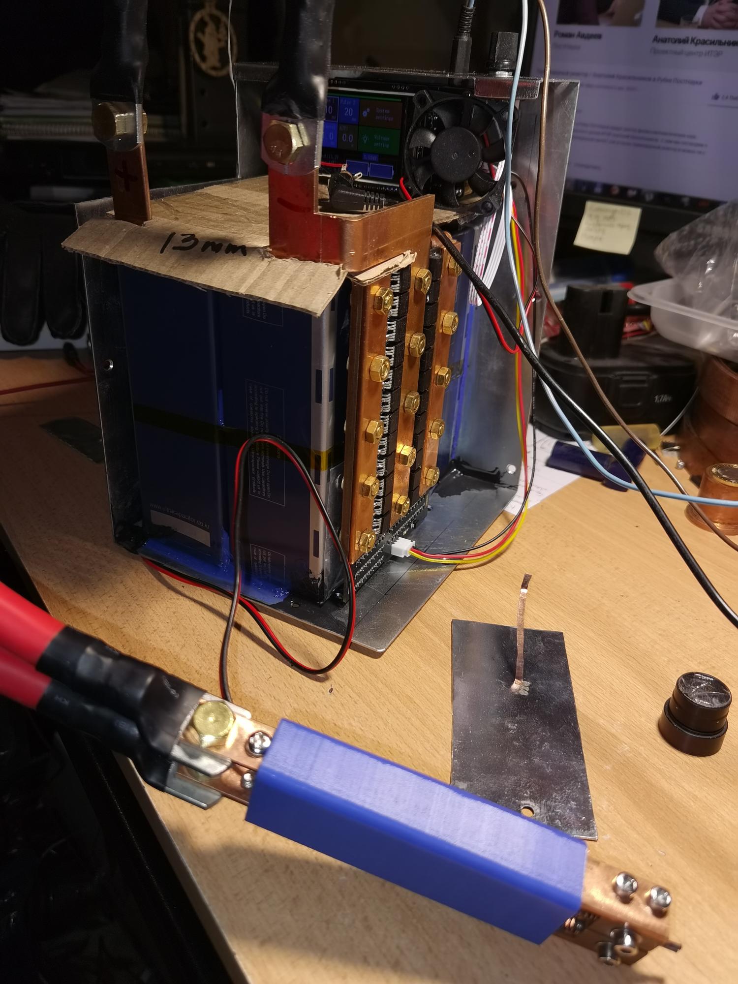

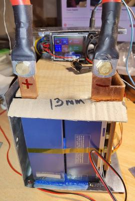

ЦитироватьСобираю именно такую, но на 6 ти кондерах.  Есть важный момент - нужно проверять тройной штекер GDS, бывает не соответствие в цвете проводов.

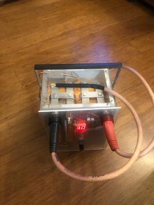

Сварку предварительно собрал и опробывал , проверил пока только на правильность подключения. Собираю из интереса и именно хочу приваривать медь.  попробывал один раз ( первый импульс 1  пауза 0,7 и второй 4,5 при напруге 5,6 вольт ), ленту  0,3 мм медь, разрезал что бы щель была между электродов, жахнул, вроде приварилась, но оторвалась руками , легко, остались следы меди на аккумуляторе 18650.
повторяюсь, проверял только работу, остальное когда корпус сляпаю.  А так и  аккумулятор ржавый и медь не зачищал.
Картоном закрыл , что бы не замкнуть.
контакты  DGS соединил что бы буквы совпадали, а не цвет.  Дисплей 6Y880- он и балансирует .

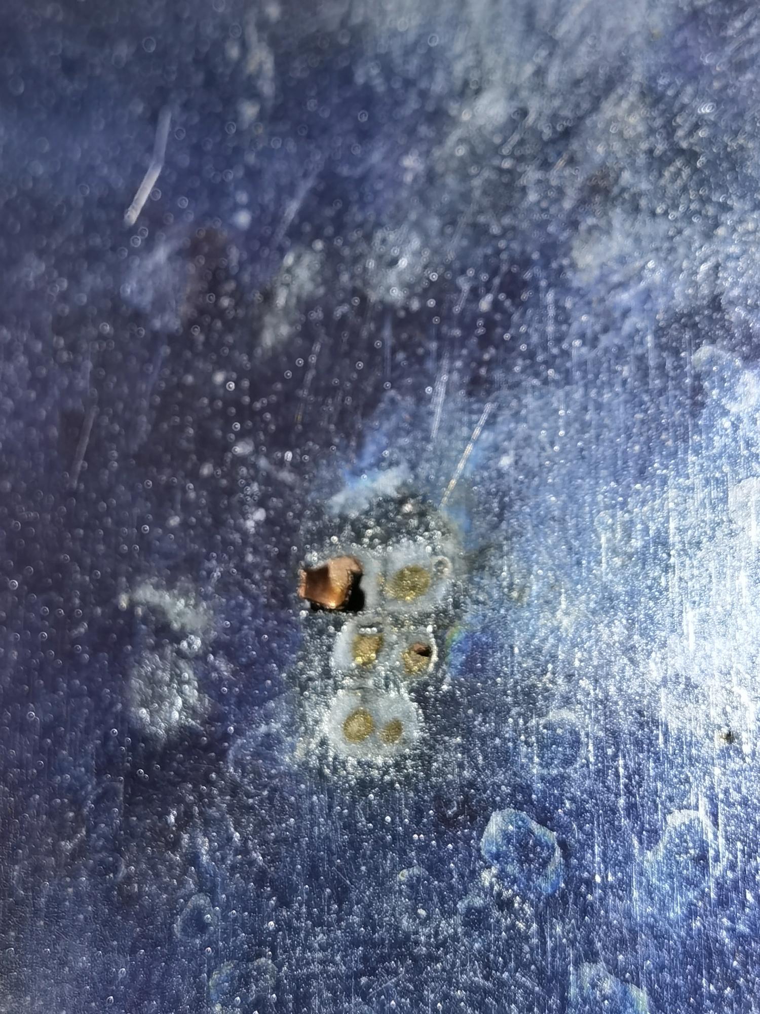

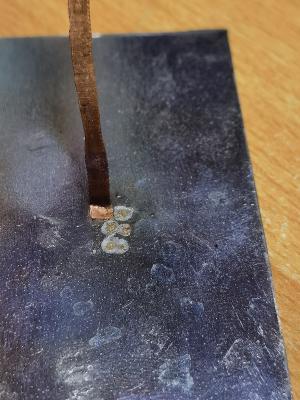

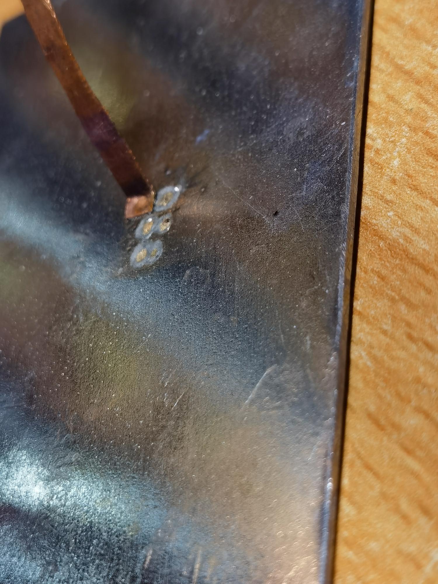

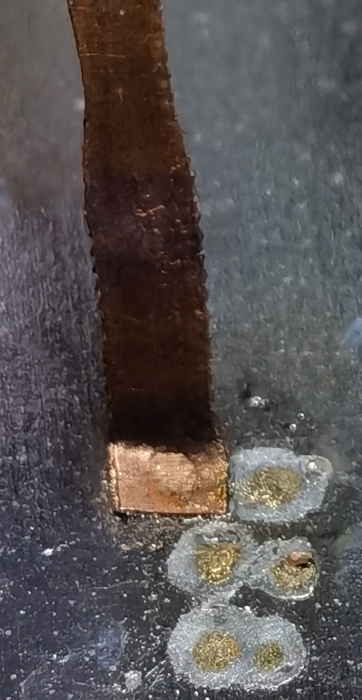

Попробывал приварить медную полоску 0,3 мм к стальной пластине 1,3 мм
электроды медные  , приваривает только отдельные пластины или с прорезью, с плюсового - намертво, рукой не отрывается.
под контактом, между пластин использовал паяльный флюс.
на мониторе видны установки, то есть в пол силы.
оторвал плоскогубцами с мясом.

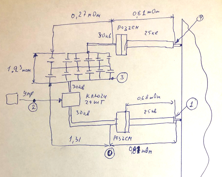

Изходя из замеров полученых при сборке сварки посчитал.
https://electrotransport.ru/index.php?topic=63182.0#topmsg
Св провода 1м 0.24мом
Кондеры 0.2/3х2=0.13мом
Шины медные примерно 45квадратов 0.4м 0.34х0.4=0.13мом
Длину шины брал условно возможно меньше тк У меня плата замерена на выходных клемах но лишние 20см это ошибка всего в 0.06мом.
Ручка свар. измерено на такая же как у вас есть в наличии (пока не подключал нет нужных проводов) 0.17х2=0.34мом
Плата с ключами измерено на аналогичной с 24 мосфетами делим на 2 получаем 0.7мом
Контактное сопротивление очень сильно затянутой пары примерно 0.05х6=0.3мом условно берем 6 соединений.
Свариваемая деталь плюс контактное сопротивление рассчитано из опытов при токе около 1500а.
1.2мом никилированная сталь
0.8 алюминий
0.4 медь
Получаем 0.24+0.13+0.13+0.34+0.7+0.3+1.2=3.04мом
5.6в/3.04=[b-b]1860ампера[/b-b] сталь
5.6в/2.64=[b-b]2120ампера[/b-b] алюминий
5.6в/2.24=[b-b]2500ампера[/b-b] медь
Уверен что точность расчета не хуже чем 10-15%.
Если есть осцилограф с памятью можно и померить реальный ток. Так же реальное сопротивление ветки с ключами легко померить открыв ключи внешним источником подав +12в на затворы и пропустив ток порядка 1-10а и померить падение напряжение в милливольтах от св. электрода до кондеров или померить спротивление всей цепи разряжая кондеры при открытых ключах через нагрузку на премер в 0.5 ома вместо св детали. Емкости хватит для замера напряжения обычным тестером.
Из соотношения сопративлений видно что очень большое влияние на ток оказывает сама свариваемая деталь и прижим поэтому не меняя ничего в щупах и степени прижима без увеличения напряжения увеличить ток в системе до значений которые в состоянии пропустить провода и ключи  ничего не получатся. Это при том что для расчета я взял минимальные из полученных значений из серии замеров. Если прижим не достаточен и появляется искра то сопротивление увеличивается.

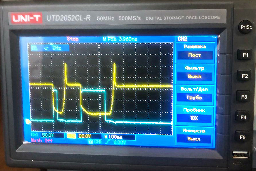

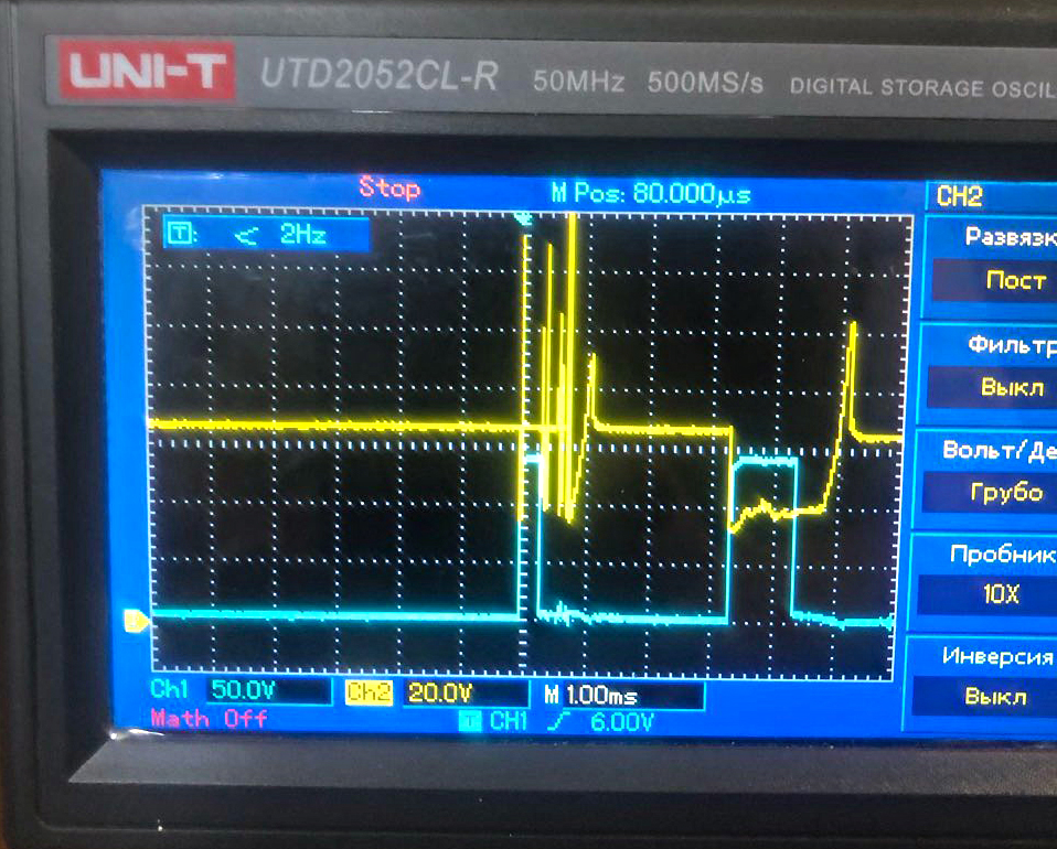

Искра на первом импульсе. Желтый луч это ток. Синий упр импульс.

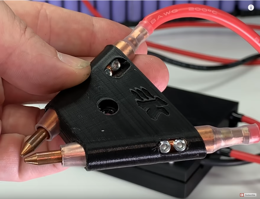

При токе 1500а (измерено) реально сварочные иглы работают максимум до 20-25мс при больших длительностях перегреваются прилипают плавиться подгорают пробовал до 50мс.

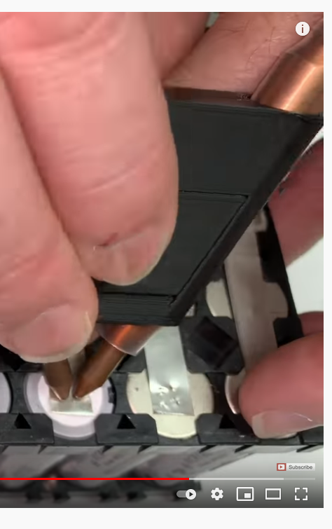

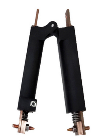

Можно попробовать другой материал и заточку без тонкого носика.
Вот тут показан вариант электродов.
https://www.youtube.com/watch?v=4UgBG0oFAwU воглядит примерно так только Вам нужно сделать по толще для больших токов.
https://secondlifestorage.com/index.php?threads/kweld-best-spotwelder-ever.8301/
Там есть ссылки такие электроды можно купить наверно.
Свою ручку буду дорабатывать установкой толстых конических электродов.

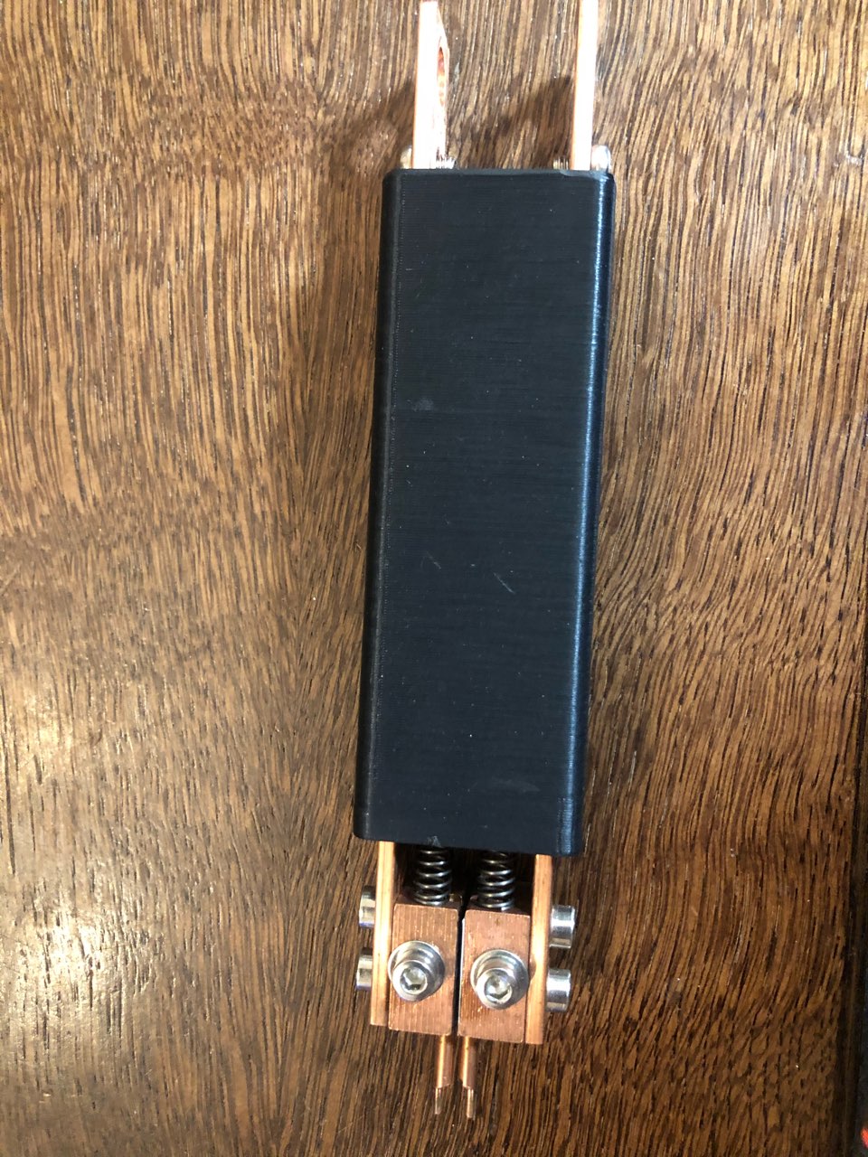

Цитата: volodiaa от 18 Апр. 2021 в 07:33Свою ручку буду дорабатывать установкой толстых конических электродов.
Крайне неудобное решение, не везде подступишься, неравномерность прижима. Большая площадь контакта требует более высокого тока.
m1011
Буду делать другой вариант как сделаю покажу. Скорее это будет 2 параллельных более толстых стержня с трехсторонней заточкой без длинных тонких концов которые быстро изнашиваются но с возможностью поставить и стандартные сварочные иглы для работы с тонкими лентами . Этот вариант дан в качестве примера для варианта на толстый металл и большие выдержки. 0.1-0.15мм лента варится прекрасно на коротких импульсах 0.1-1мс и обычные иглы отлично работают.
Мурена3+Хантер32, фловер33t+микота45, лифер45+60+2х50, ШИМ контроллер по схеме от LICC доработанный на 12в.

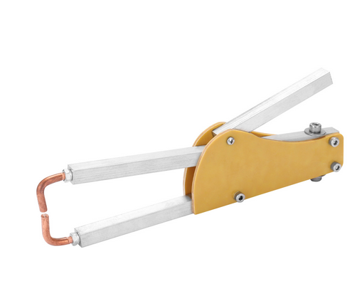

Silvaticus
[user]m1011[/user], там еще и сплав медный немного иной. Может проще взять готовую ручку под 3мм стандартные электроды?
m1011
Готовая ручка  есть до этого использовал на меньшем токе хватало. Ток поднял в двое 1500а и таймер двойного импульса дает выдержку до 99мс.  Щупы буду ставить разные. Обычные и более толстые под большие выдержки. У ручки снимаются как щупы так и держатели щупов. Обычные щупы с тонкими концами 1.5мм на больших выдержках перегреваются и быстро укорачиваются. Начну с варианта 3 мм если будет надо то и более толстые попробую. Пока жду более толстые провода для ручки.
Кнопку снял пока за не надобностью.
