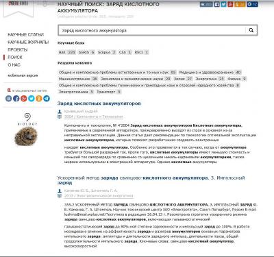

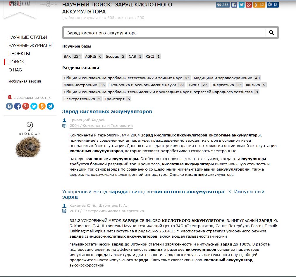

[user]Vova_n[/user], не могли бы вы скинуть ссылки на публикации исследования влияния импульсного заряда на АКБ на русском языке?

[user]serggio[/user], Ну воспользуйтесь там поиском  :hello:

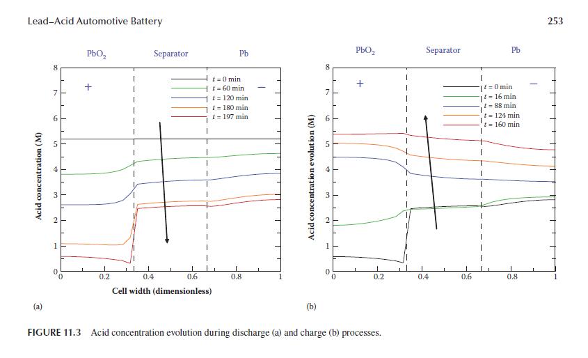

Дм.

"Electrochemical energy. Advanced materials and technologies"
2016 Taylor & Francis Group, LLC

Требуется подсказка зала: что за единица измерения концентрации кислоты М?
Как она переводится в плотность или проценты?
Предполагаю Моль.
Мольная концентрация
[user]Дм.[/user], неплохо бы еще текст к рисунку приложить
Figure 11.3 demonstrates the acid concentration evolution inside a cell of the battery. The discharge and charge processes are conducted at I = 20 A. It is indicated from Figure 11.3a that acid concentration decreases faster in the positive electrode than in the negative electrode; thus, H+ diffuses from the negative electrode to the positive electrode. The steep drop at the interface between the positive electrode and the separator is due to the intense electrochemical reaction at the interface. Figure 11.3 shows the acid concentration recovery during the charge process. It can be seen that the acid concentration in the positive electrode increases gradually
due to the H+ production, and the diffusion is now from the positive side to the negative side. The electrode potentials are governed by the Nerst equation (Equation 11.3) below. From this equation, it can be seen that during charging, the H+/HSO− 4 concentration increases at both electrodes; thus, the potential of the positive electrode will become more positive and that of the negative will become more negative, which causes the cell voltage to rise. During discharge, the concentration of H+/HSO− 4 decreases, which results in the positive electrode potential being less positive and the negative electrode potential being less negative; thus, the cell voltage drops.
В двух словах, это разница в концентрации кислоты на положительном и отрицательном электроде в процессе заряда и разряда. И время его выравнивания.

Именно так. Молярная концентрация. Чтобы не тянуть страницы из справочника, перевод в плотность:
5 М - 1,29 г/см3
4 М - 1,23
3 М - 1,18
2 М - 1,12
1 М - 1,005
Это не время выравнивания. Это время с начала разряда - слева - потом время с начала тут же начатого следом заряда - справа.
Распределение концентрации кислоты в межэлектродном пространстве.

[user]Дм.[/user], если бы это было не время выравнивания плотности кислоты по снятию нагрузки или зарядного напряжения в районе электродов, то не было бы смысла графика в минутах
Дм.
Чтобы было понятно:
вариант 1 - что происходит потом - выполнили разряд/заряд, после завершения процесса через интервалы времени снимается кривая плотности.
вариант 2 - что происходит во время - проводится разряд/заряд, через интервалы времени с начала процесса снимается кривая плотности.
Я говорю о варианте 2.
