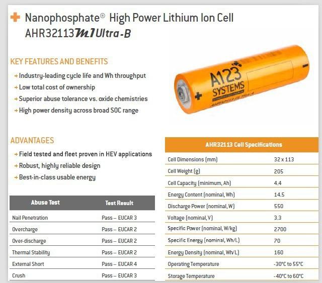

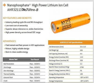

Specification :
1. Model NO.:A123 AHR32113Ultra-B
2. Material:Lifepo4
3. Typical capacity:4.4AH
4. Nominal Volt:3.3V
5. N.W:185g
6. Dimension: (D x H):32mm x 113mm
7. Maximal Charge Rate:5C(20A)
8. Continuous Discharge C:30C(120A)
9. Pulse Discharge C:60C(240A)
10. Working Charge Temp:0~50°C
11. Working Discharge Temp:20°C~50°C
12. Power:Over 2700 W/kg and 6000 W/L
13. Safety:Excellent abuse tolerance and environmentally friendly
14. Life:Excellent calendar and cycle life
15. Applications:Commercial truck and bus hybrid electric vehicles (HEVs),Off-highway HEVs,Passenger HEVs
