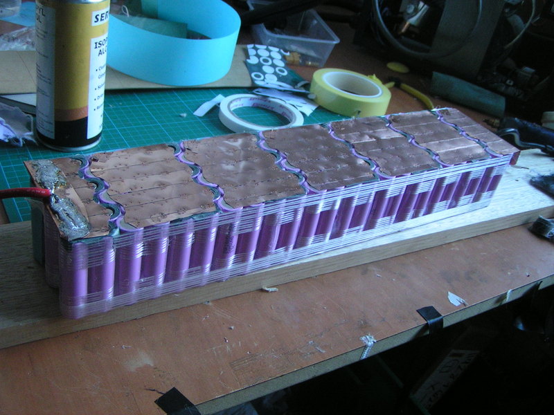

I have a problem with a max-e that is only giving ~ 50% power.
im running 22s, max 90v with a qs205.
at first the controller was giving good torque and speed up near 90kph, with boost set to max 131A b, ~300A ph. up around 11kw max, at near full charge...90v or so
riding the next day, the controller is only giving ~55A, 75kph max. the torque and regen power are also greatly reduced.
Its strange as there are no protection warnings, the controller seems to be normal otherwise.
I dont think its limiting because of  the battery high voltage because it doesnt change below 85v.
Could anyone give me some answers for this?
Many thanks

[user]ridethelightning[/user], try to make "advansed > system reset".
Maybe does the battery not produce more than 55A?
If there is a non-Adaptto BMS - check it.

Thanks for the reply.
new 22s12p samsung 30Q, copper connections...good for 190A B-)
adaptto bms also seems ok. cells @ ~0.010 difference, hvc/lvc correct too.
i have not tried the system reset yet. I will try that next.
