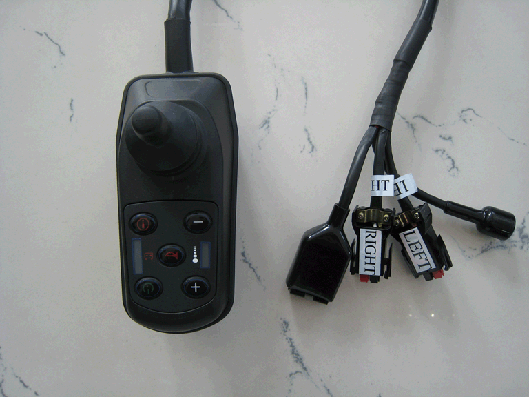

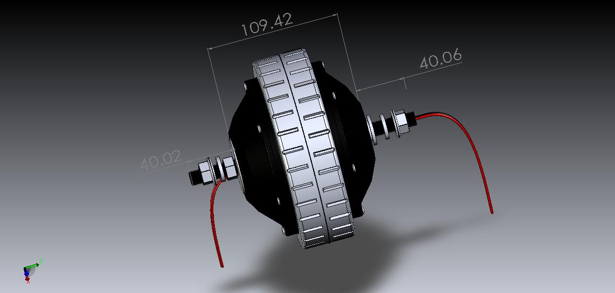

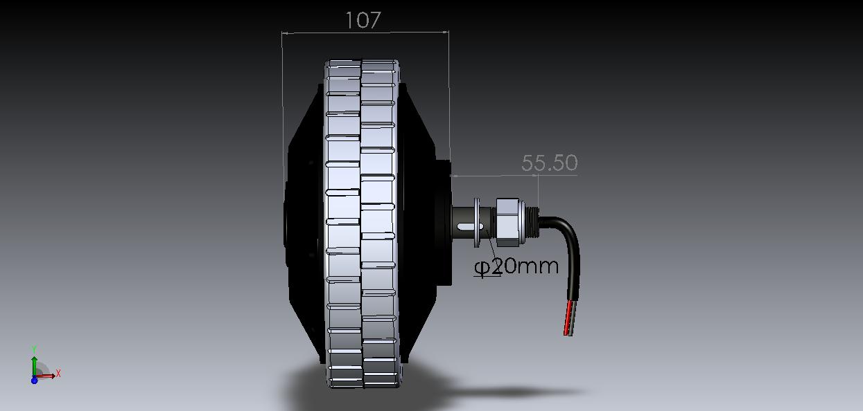

Не именно такие, но имеются:
http://www.goldenmotor.com/hubmotors/HUB-24M.jpg
http://www.goldenmotor.com/hubmotors/PW-10S%20drawing.pdf
http://www.goldenmotor.com/hubmotors/HUB24T6%20inch%20-%2024V75W.jpg
http://www.goldenmotor.com/hubmotors/8%20inch%20-%20single%20side%20shaft.jpg
http://www.goldenmotor.com/wheelchair%20motor%20drawing%202009.pdf
Там же и джойстик готовый есть:
http://www.goldenmotor.com/IM%20Joystick%20Controller%20-%20Large.gif
