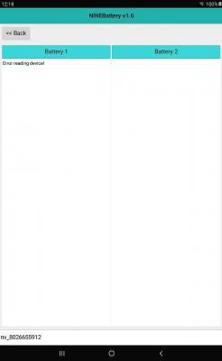

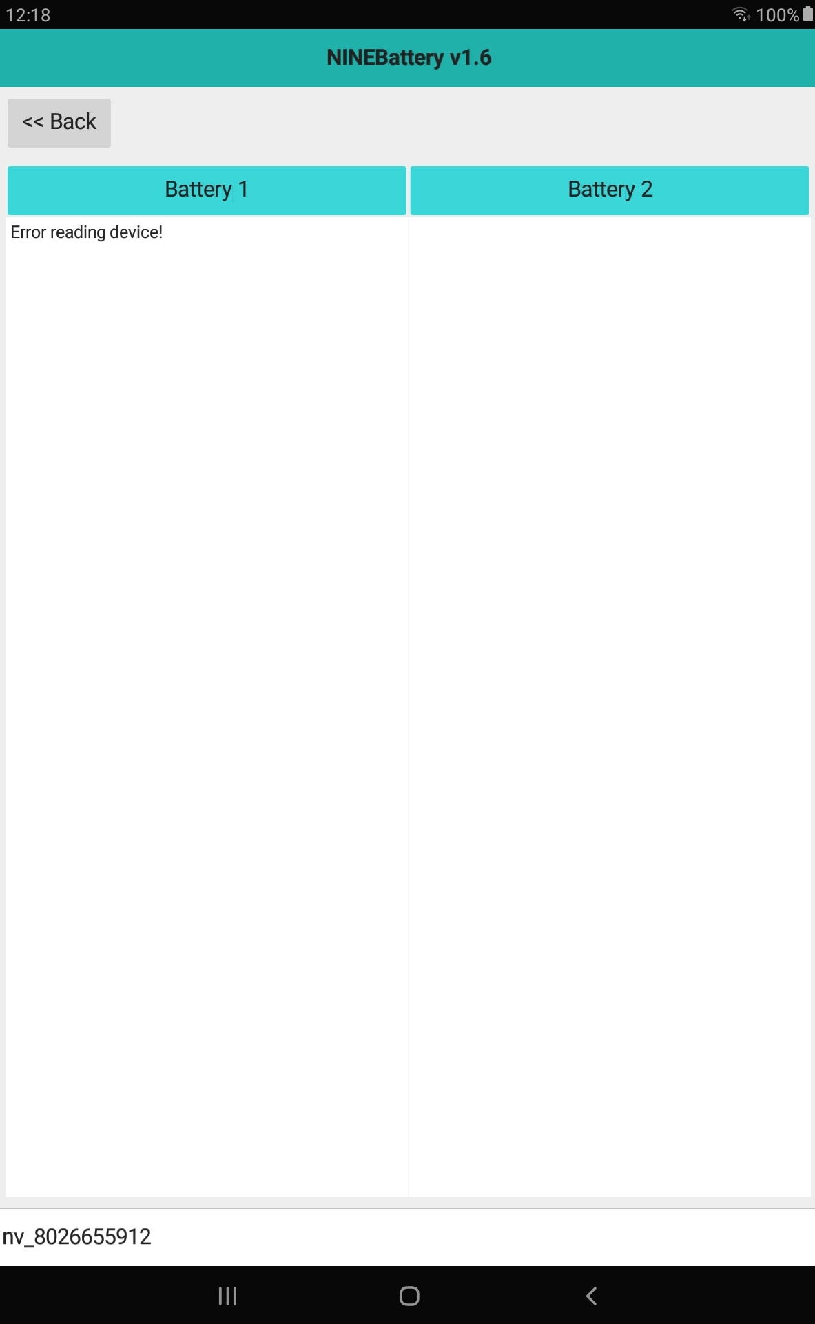

[user]flamaest[/user], Check the quality of the interface wire connection from the controller to the battery, the controller does not see the battery.
flamaest
I appear to get the same error even if I use the scooter with only its internal battery. I also have two other external batteries and if I connect them, the software still reports a device error. It does not appear to connect. I also tried installing the app into two other tablets which older versions of Android.

[user]flamaest[/user], Tell us how it all started. The problem with the scooter occurred immediately after installing an external battery, or did it work normally for some time? Were there any previous manipulations with the scooter's stock controller? The scooter is not carsharing?
flamaest

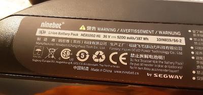

Thank you my friend. I purchased a scooter new and later purchased a secondary battery for it also brand new. There are no manipulations with the scooter and it is running the factory firmware.
I only drive the scooter two or three times a year for fun.  last year I took my scooter to the beach boardwalk and noticed that I was only able to do about 10 miles instead of the normal 27, and when I got home I tried to put the scooter on the charger and notice that it was no longer charging through the secondary battery connector.
I remove the secondary battery and plugged into scooter directly and it charged okay.  the secondary battery still shows power life, still lights up, and still actually works but it will not allow charging to occur.
I purchased two other used  secondary batteries on eBay, which are now very cheap to purchase. These work perfectly and are able to charge the scooter in the secondary battery without an issue. This is how I confirmed that my first secondary battery somehow stopped working after around the fifth charge. It simply does not allow a charge to go through itself and to the scooter.
the scooter app still properly shows the primary battery and secondary battery, even though the secondary battery is not allowing a charge to go through it.
I am sure that someone who understands about these batteries could probably fix the problem, perhaps the secondary battery has a simple fuse or something built-in that can be replaced.

Thank you. The connector is working well. There is no cable or connector issue, they are not loose or damaged. If I plug in the connector to the battery, while attached to the scooter, it turns the scooter ON, but does not start charging any of the two batteries (internal and secondary).
If I replace the secondary battery, all works as expected.
tak1973
[user]flamaest[/user], You do not have a current pass from the external battery charging connector to the connector on the steering rack. Do you have a multimeter? Check the charge current transit between the connectors on the external battery.
flamaest
thank you, I took a multimeter to the connectors and they show 35 volts coming off the secondary battery. Are there other battery connectors that you would like me to test for correctness?
