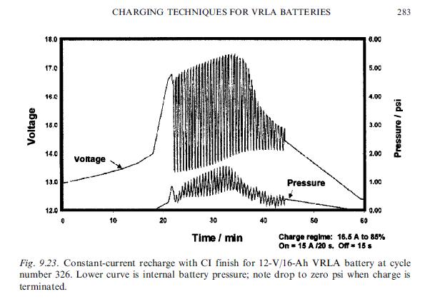

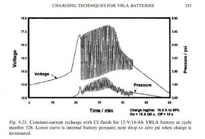

Пример измерений давления из монографии "Valve-regulated Lead-Acid Batteries":
ЦитироватьA typical CI charge curve is given in Fig. 9.23, together with pressure measurements. In spite of achieving voltages in excess of 17V during pulsing (no voltage limit is imposed), hydrogen evolution is minimal, as can be seen by the pressure decay to zero after charge is terminated, with any remaining oxygen being scavenged by the negative plate.

Ситуация с реалиями на приведенной картинке - давление поднималось до 1,5 psi при росте напряжения до 17 В.
