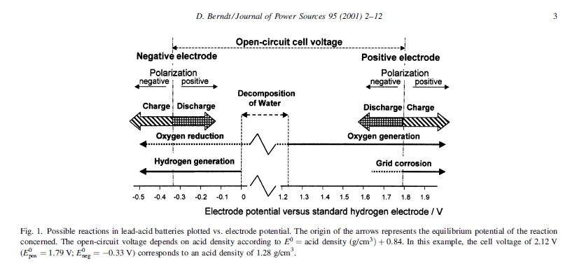

Цитата: UDAV от 25 Сен. 2017 в 22:00
[user]UriBas[/user],  электролиз, как и я, человек простой :D  Превышено напряжение  начала электролиза - процесс пошел.  Нет - нет.   Куда уж проще.
Я пытаюсь донести суть - электролиз зависит от на-пря-же-ни-я  в первую очередь.  ...
Читайте - про напряжение:
Цитировать2. The electrochemical system ``lead-acid battery''
The lead-acid battery is an unstable system, since [b-b]the decomposition voltage of the water in its electrolyte amounts to only 1.23 V which is far below the nominal cell voltage of 2 V.[/b-b] Furthermore, at the high potential of the positive electrode, all metals are destroyed by oxidation and only lead can be used for the grid and the conducting elements, since the corrosion of lead generates a protecting layer of lead dioxide. Even this layer is not quite stable, and corrosion causes a small continuous current flow. As a consequence, in lead-acid batteries, water decomposition and lead corrosion are to be accepted as unwanted secondary reactions. To illustrate the situation, the possibility of the various reactions is drawn in Fig. 1 versus the electrode potential refered to the standard hydrogen electrode (SHE).
[b-b]Polarization is a decisive parameter. It means the deviation from the equilibrium potential, caused by current flow[/b-b]. Whether the electrode is charged or discharged, depends on its polarization. ... The extent of the polarization determines the rate of the reaction concerned.
The charging/discharging reactions are fast at both electrodes, which means that charging or discharging occurs at a high rate, even at a small deviation from the equilibrium value (small polarization).
так что, если нужный ток приложить, то конечно:
Цитата: UDAV от 25 Сен. 2017 в 22:00Можно и  полностью разряженную АКБ  заставить закипеть, лишь бы  у БП силенок хватило напряжение  выше уровня начала электролиза удержать.
